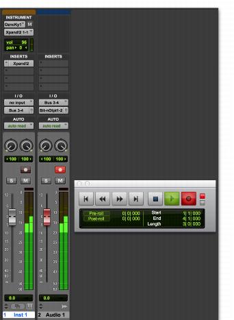

4. Create a new audio track with the same number of channels as the Instrument track (such as stereo).
5. Set the Instrument track’s Audio Output Path selector to a bus (for example, Bus 1–2).
6. Set the audio track’s Audio Input Path selector to the same bus.
7. Set the audio track’s Audio Output Path selector to the main monitoring path.
8. Record enable the audio track.
9. Do one of the following:
*To record from the beginning of the project, click Return To Zero in the Transport.
*Make a Timeline selection for the record range.
10. Click Record in the Transport to arm Pro Tools | First for recording.
11. Click Play in the Transport to start recording
Bus recording audio from an instrument plug-in
12. When your previously recorded MIDI performance is finished playing, click Stop in the Transport to stop recording.
