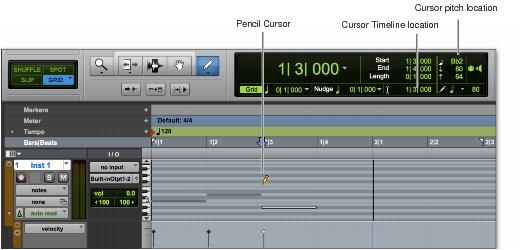

4. Move the Pencil tool into the MIDI or Instrument track. Use the Edit window’s ruler and the track’s mini-keyboard as a reference to locate the pitch and time location you want.
When using the Pencil tool, the Cursor location and value are displayed in the Window Toolbar.

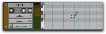

5. When you reach the pitch and time location you want, click to insert the note.
MIDI note inserted with the Pencil tool

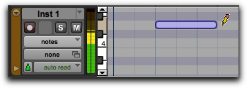

The Pencil tool can be dragged after clicking (and before releasing) to adjust the note’s pitch or duration. Drag right to lengthen the note without changing its start point. Drag left to shorten the note without changing its end point.
Adjusting the duration for an inserted note
