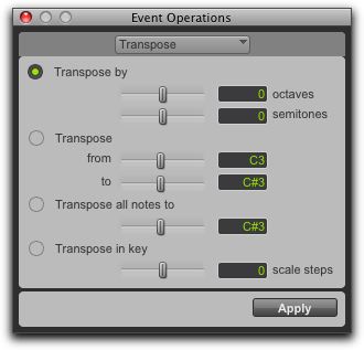

Event Operations window, Transpose
• Transpose By (Octaves)
Transposes selected MIDI notes by up to +/– 10 octaves, or transposes selected Elastic Audio clips up to +/– 2 octaves.
• Transpose By (Semitones)
Transposes selected MIDI notes up or down chromatically by up to +/–127 semitones, or transposes selected Elastic Audio clips up or down chromatically by up to +/– 48 semitones (4 octaves).
• Transpose (From and To)
Transposes selected MIDI notes, or selected Elastic Audio clips, by semitones, as expressed by the difference between the source and destination pitches. Transposing from C3 to F#3, for example, transposes the notes up by an augmented fourth (six semitones).
• Transpose All Notes To
Transposes all selected notes to the same pitch. Use the slider or the number entry box to enter the pitch to which to transpose all selected notes. This option is not applicable to Elastic Audio clips.
• Transpose In Key
Transposes selected notes in key up or down by scale steps (based on the Key Signature ruler). This option is not applicable to Elastic Audio clips.
To transpose MIDI notes:
1. If you will be transposing a group of tracks, enable the Edit Group.
2. Select the MIDI notes you want to transpose.
3. Choose Event > Event Operations > Transpose.
*Press Option+T (Mac) or Alt+T (Windows) to open the Transpose window.
4. Select the Transpose option (By, From and To, All Notes To, or In Key).
5. Set the corresponding pitch fields.
a. With any pitch field selected, play a note on your MIDI controller to automatically enter it as the pitch value.
6. Click Apply.
