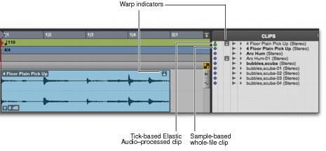

4. A new tick-based audio track is created with the Polyphonic Elastic Audio plug-in enabled.
5. Since you chose to not import the file’s original tempo, you will notice that the loop conforms to the tempo map and Bar|Beat grid of the project. A Warp indicator appears in both the clip in the track and in the Clips List.
Also in the Clips List, notice that there are two clips. One is the sample-based whole file clip (the imported source file) and the other is the tick-based Elastic Audio–processed copy.
*You can also conform clips on Elastic Audio-enabled tracks to the project tempo using the Conform to Tempo command (see “Conform to Tempo” on page 742).
Imported tick-based audio file with Elastic Audio processing

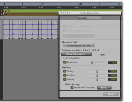

Quantize audio to apply a Groove Template:
1. Select the clip on the tick-based, Real-Time Elastic Audio-enabled track.
2. Choose Event > Event Operations > Quantize.
3. In the What to Quantize section, make sure Elastic Audio Events option is selected.
4. From the Quantize Grid pop-up menu, select a Groove Template.
5. Set any other options.
6. Click Apply.
7. In the following figure, notice that the audio has been quantized according to the selected Groove Template. In Warp view, you can see that Warp markers have been added at every Event marker near the Quantize Grid and were used to apply quantization to those events.
Quantized audio events (Warp markers) in Warp view
