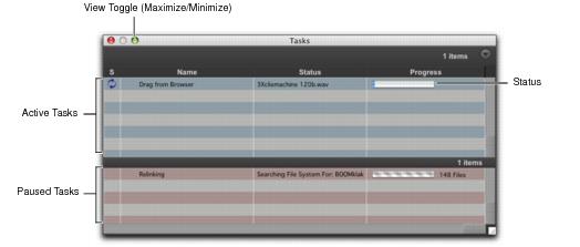

For maximum performance and flexibility with file management tasks, Pro Tools provides the Task Manager window. File management with Pro Tools involves nearly constant creating, copying, converting, processing, searching, and indexing files.
These tasks occur in the background, letting you continue recording, editing, and mixing without delay.
The Task window lets you monitor, pause and cancel ongoing tasks including file copying, fade regeneration, and indexing.
Task window, maximum view
