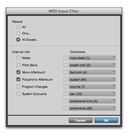

1. Choose Setup > MIDI Input Filter.
2. In the MIDI Input Filter dialog, select the All Except option.
3. Select the option for Program Changes. Leave all other messages deselected.
4. Click OK.
When using the All Except option, the selected types of MIDI messages are not recorded. Conversely, when using the Only option, only the selected types of MIDI messages are recorded.
