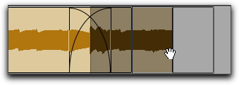

1. Use the Grabber tool to select one of the contributing clips to a crossfade.
Selecting a clip with a crossfade

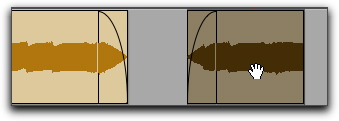

2. Drag the selected clip with the Grabber.
Separating clips while preserving fades
