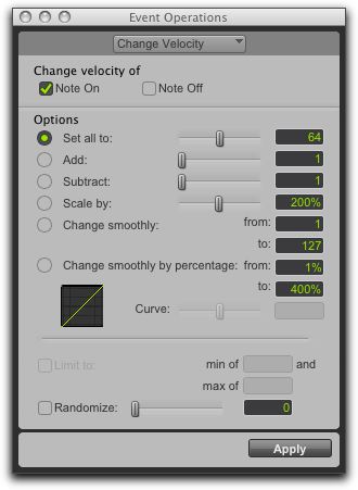

Event Operations window, Change Velocity page

• Note On
Applies the Change Velocity options to the MIDI Note On.
• Note Off
Applies the Change Velocity options to the MIDI Note Off.
*While there are options for adjusting both the Note On (attack) and Note Off (release) velocities for notes, most MIDI devices ignore release velocity information. To see if your instrument supports release velocities, see the manufacturer’s documentation.
• Set All To
Sets all velocities to the specified value (1–127).
• Add
Adds to existing velocity values by the specified amount (1–127).
• Subtract
Subtracts from existing velocity values by the specified amount (1–127).
• Scale By
Scales all velocities by a percentage amount (1–400%).
• Change Smoothly
Allows velocities to change smoothly from one value to another over time.
• Change Smoothly by Percentage
Allows velocities to change smoothly from one percentage value to another over time.
The curve for this change can be adjusted (+/– 99) to affect how gradually the change occurs.
• Limit To
When selected, restricts the Change Velocity command to a minimum and maximum range after the selected Change Velocity option has been applied (and also after any randomization has been applied).
• Randomize
When selected, the selected Change Velocity option is randomized by the specified percentage value after the selected Change Velocity option has been applied. For example, with the Set All To option enabled and set to a value of 64, and with Randomize enabled and set to a value of 50%, the resulting velocities will be anywhere between 48 and 80 (+/– 25% of the velocity value).
To randomize selected velocities without applying any other Change Velocity options:
1. Enable the Scale By option and set it to 100%.
2. Enable Randomize and set the amount of randomization you want.
3. Click Apply.
