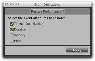

The Restore Performance command in the Event Operations window reverts all selected MIDI notes to their original state (when first recorded or manually inserted), even after the project has been saved, or the Undo queue has been cleared. Restore Performance can also be applied to quantized Elastic Audio Events or quantized audio clips.
Event Operations window, Restore Performance page
*The Restore Performance command can be undone.

To restore the original time, duration, velocity, or pitch for selected MIDI notes, audio clips, or Elastic Audio Events:
1. Select the MIDI notes, audio clips, or Elastic Audio Events you want to restore.
2. Choose Event > Event Operations > Restore Performance.
3. Select which performance attributes to restore.
4. Click Apply.
