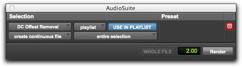

To remove DC offset from an audio clip:
1. Select the clip with DC offset.
2. Choose AudioSuite > Other > DC Offset Removal.
3. Ensure that Use In Playlist is enabled.
4. Click Render.
