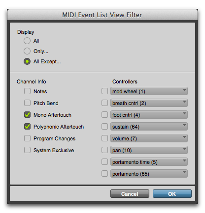

2. In the MIDI Event List View Filter dialog, select the All Except option.
3. Select the options for Mono Aftertouch, Polyphonic Aftertouch, and System Exclusive. Leave all other messages deselected.
When using the All Except option, the selected events are not displayed. Conversely, when using the Only option, only the selected events are displayed.
