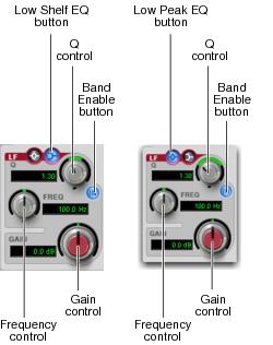

Low Shelf EQ (left) and Low Peak EQ (right)
The Low Shelf and Low Peak Gain controls and their corresponding graph elements are displayed on-screen in red. The following
control values are available:
