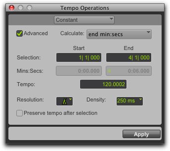

The Constant page in the Tempo Operations window lets you create a constant tempo over a selected range of time.
Constant page (Advanced Option)
• Advanced
When this option is selected, the selection range changes to the Main Time Scale format, and additional and modified options become available.
• Calculate (Advanced Option)
Calculates either the tempo, or the selection end time.
• Selection Start and End
Specifies the start and end point for the tempo change in Bars|Beats. When an Edit selection is made, the Start and End fields will display the selection boundaries.
• End Time (Advanced Option)
Displays the selection end time. When the Main Time Scale is set to Bars|Beats, the end time is displayed in the Sub Time Scale. When the Main Time Scale is set to any absolute timebase, the end time is calculated and displayed in Bars|Beats. Changing the end time value causes the tempo to change.
• Tempo
Specifies the tempo, in beats per minute (BPM), to apply to the selected range.
• Resolution (Advanced Option)
Lets you select the BPM note value for your tempo setting.
*Selecting “Follow Metronome Click” will set the tempo BPM note value to mirror the click value set in the meter markers.
• Density (Advanced Option)
Lets you specify the density of the tempo change events written to the Tempo ruler.
• Preserve Tempo after Selection
If selected, the previous tempo setting that was in effect at the selection end point is preserved after the selection. If unselected, the last tempo event created by the tempo operation continues to the end of the project, or until the next tempo event beyond the selected range.
