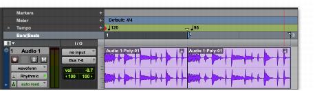

In the following figure, the first two-bar clip is at a tempo of 120 bpm. The second two-bar clip has been conformed to the tempo change of 96q bpm. Since the second clip has been warped to remain two bars long at the slower tempo, it displays the Clip Warp indicator in the upper right-hand corner of the clip.
Tempo conformed audio, linear tempo change
